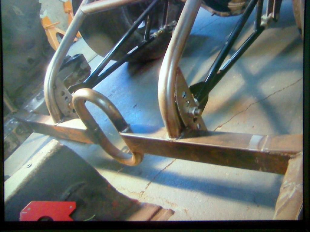

Do you have a 2x3 rear crossmember or is it round tube?

yes its a 2x3 cross member. the cm tubing comes off that. I will post pic tonight hopefully.

so basically all you wanna do is extend a straight 2x3 rail from that stub all the way back to your 2x3 crossmember if i am reading ya rite correct?

Pictures uploaded for injectedrat68
Zip.

Yeah, this is a pretty straight forward project. You're going to need to tie in the front down legs on the clip, into the front of the roll cage structure. Remember to incorporate TRIANGULATION in ALL of the roll cage.
Looks like FUN !!

Whats the rule on 2x3 when you add on. You have to plate it and over lap by how much i would think on all 4 sides. Any special way i should notch the 2x3 to butt togeather, or just butt them togeather flush. That doesnt look right by putting togeather flush.
I have butt welded 2X3 frame rails but i welded a 2"X4"X1/4" tk plate on each side of the butt welded section.
Zip.
