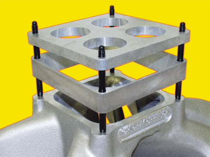

As far as spacers, they are usually a bandaid for some other issue. Intake plenum size too small or large, too much reversion from the cam or intake runner length incorrect. With that said, a lot of engines can improve from a spacer of some sort, unfortunately it a trial and error thing. If you have none to borrow and want to purchase something, I would suggest something like the anti-reversionary spacer below sold by Reher-Morrison. If it wants any at all it will probably gain with that one, and less likely to lose any. Available for 4150 or 4500 carbs. And if it does help, remember you are affecting the signal at the carb and may need a jet change.

*"spacers" I understand the bandaid comment > my way of thinking > being I'm using a dual plane intake for lower RPM throttle response and drive-ability 'maybe' a spacer will trick my Wieand Stealth to act more like a Team-G and add a little more RPM to WOT...no?
*or, would a Edelbrock Victor be a better direction?
